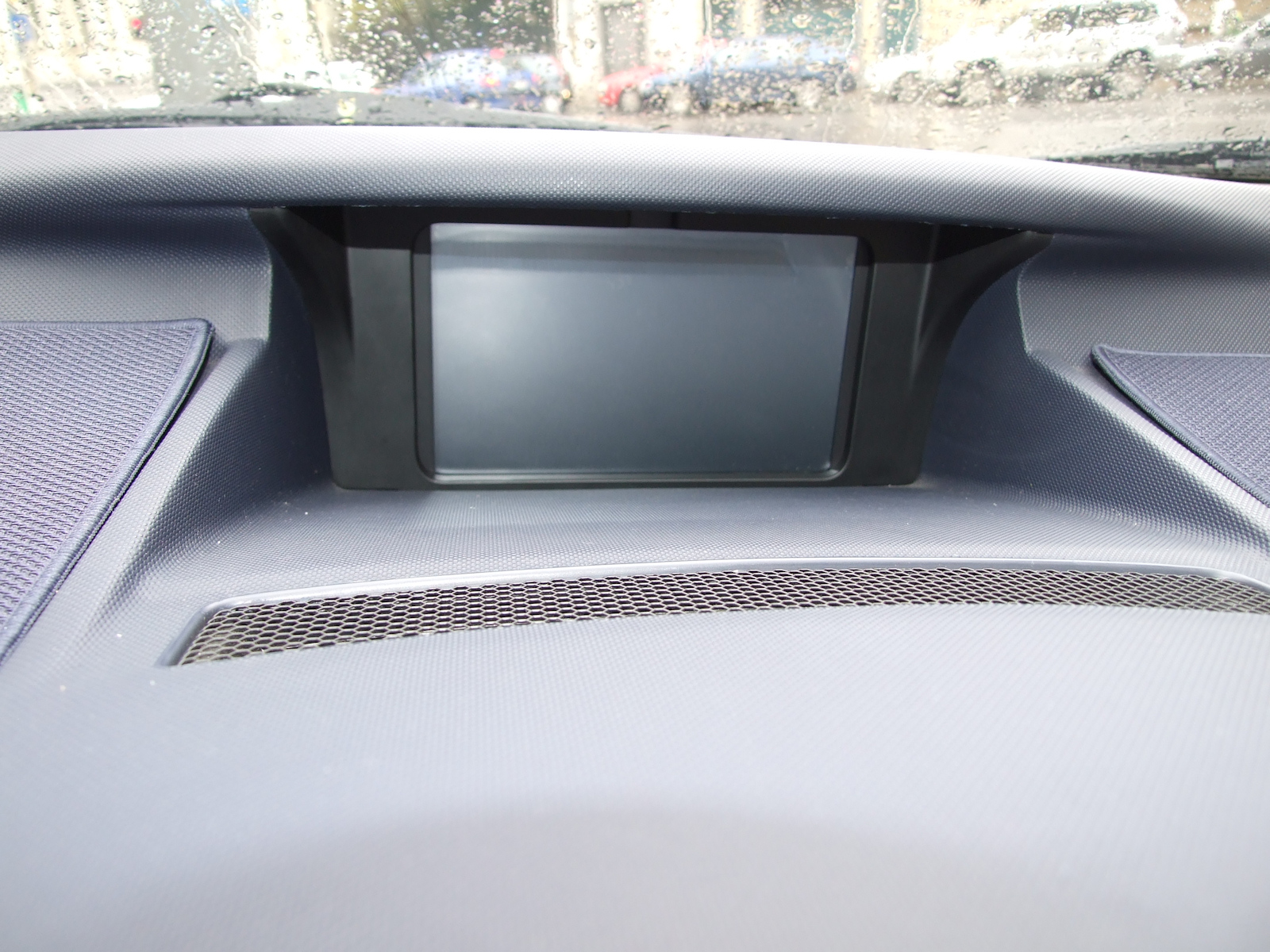

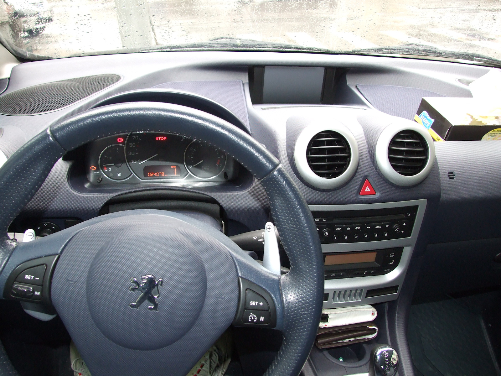

monitor installed:
http://www.imagehosting.club1007.net/im ... CF3634.jpg" onclick="window.open(this.href);return false;
http://www.imagehosting.club1007.net/im ... CF3633.jpg" onclick="window.open(this.href);return false;
