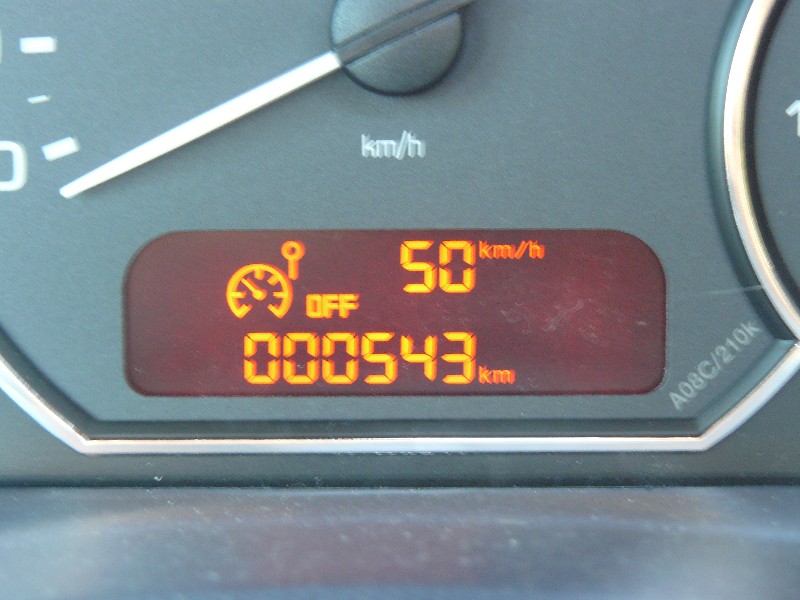

Good evening,
I found a couple of problems on my new 1007 (well, new for me, it`s a second hand car) and I want to ask your opinion:
- when I use the cruise control nothing comes up on the screen
- although the car has made only about 20.000 km the automatic gearbox makes creaking noises every time it engages the clutch.
- the gearbox has moments when although it is into first gear, the car won`t start moving.
- uneven idle RPM. Varies by 100-200 RPM
This is what I remember right now, I will update as soon as I find other problems.
P.S. Is there any way I can enter the diagnostic menu? (I have the second type of screen)

- Display information on the handset is not available on 1007 2006, this function appeared in 2007.
- The clutch squeaks also on my 1007, according to Peugeot is a normal operating sound.
- If I understand correctly when the first is on and you accelerate, the car does not? is that the editor got into the towers or the accelerator has no effect?
- When your idle is unstable, is that air conditioning is running? the idle is a little higher when the air conditioning compressor is running.
- On the screen of ODB, you have access only to consumption. If you want more information, connect a computer with the diagnostic interface OBD.
Your 1007 to how many miles?

"- Display information on the handset is not available on 1007 2006, this function appeared in 2007."
This is odd, as I can see the letters for the cruise control display disabled on the LCD when looking carefully at it. Is it normal.

There was indeed an update of computer 2tronic, I do not know the corrections to make.
I also see the symbols of the regulator on my handset but it is not active as of 1007 all before 2007.
