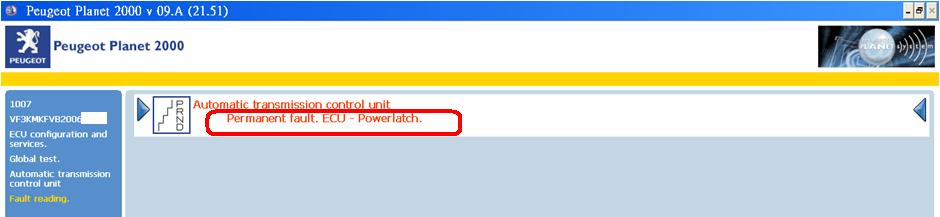

Par l'utilisation de PP2000, un défaut peut être trouvé comme ci-dessous.
"Permanent fault. ECU - Powerlatch." (Défaut permanent. ECU - Powerlatch.)

By use of PP2000, a fault can be found as below.

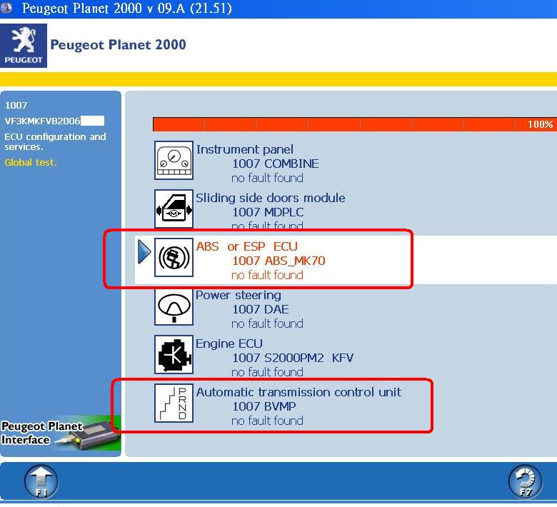

Je viens de vérifier avec PP2000.
Oui, il est étrange qu'il n'y ait pas d'enregistrement de défaut dans le PP2000!
Tant l'ABS / ESP et l'ECU de la boîte de vitesses n'ont aucun message d'échec.
(Ma voiture n'a pas l'ESP, mais il a l'ABS.)
J'ai pensé que si l'ECU a fait quelque chose qui est anormal, il devrait au moins laisser un message de code?!
C'est la seule chose qui ne peut pas être expliqué.

I just checked with PP2000.
Yes, it is strange that there is no fault record in the PP2000 !
Both the ABS/ESP and the ECU of gearbox have no failure message.
(My car has no ESP, but has ABS.)
I thought if the ECU did something that is abnormal, it should at least leave a code message ?!
This is the only thing that can not be explained.

Yes, I disconnected the battery, and connect it again, without driving my car, then I found there is a 'POWERLATCH' failure code message.
Identical as the above.
I cleared that report immediatelly. I think it was generated by disconnecting the battery.
(Mayby I were wrong ?)
Then I drove on highway, the problem occurred but no report.
There is one more thing caught my attention.
When I accelerated the car smoothly, it will engage in 5th gear.
If I accelerated the car suddenly, it won't engage in 5th gear.
So I guess the Slipping of the front tires are greater than the rear tires.
(my front tires are older. about 10000 kM)
This could generate extra difference in speed, if I accelerate fast.
Then the ECU might be triggered to inhibit the 5th gear change.
For now, I guess there are two factors that make the problem occurred :
1. Difference in circumference of tires.
2. Mix of old and new tires causing the difference of sllipping.
If I move the new rear tires to front wheel, the problem could have chance to disappear.
Unfortunately, I just checked the tires that were installed by the workshop, they are so tight that I cannot change them by hand.
(They never used torque wrench.)
I'll go back to the shop and ask them to change for me.
I'll report to the forum after that.

J'ai utilisé PP2000 pour mesurer la vitesse des roues et trouve la différence entre le pneu avant et le pneu arrière est d'environ 5%.
Compte tenu de la stabilité dynamique, en particulier dans les jours pluvieux, j'ai décidé de ne pas échanger les pneus avant avec les pneus arrière.
I used PP2000 to measure the wheel speed and found the difference in between front tire and rear tire is about 5%.
Considering the dynamic stability, especially in rainy days, I decided not to exchange the front tires with rear tires.
